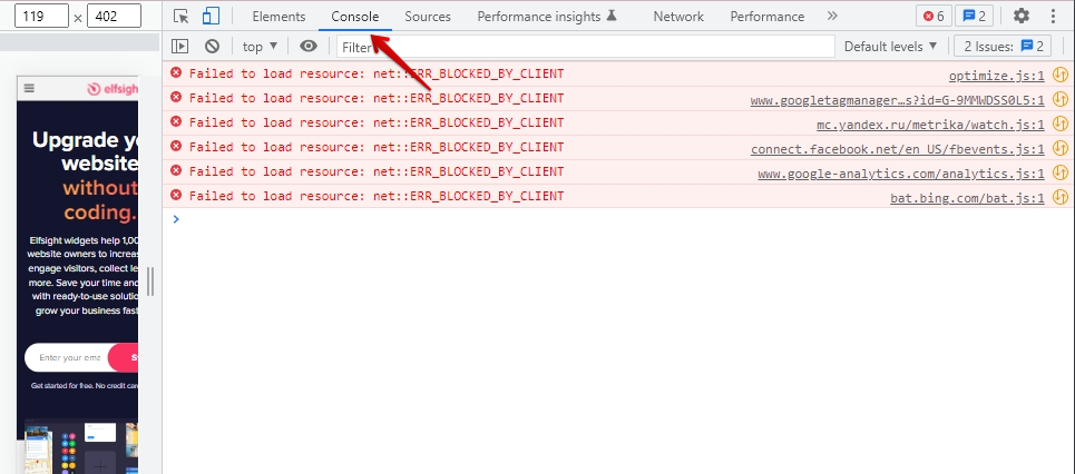

1. Check Developer Console for Errors
The Developer Console is a built-in browser tool that shows technical messages. If your map isn’t loading, Google will display errors in the console, helping you identify the exact cause.
To open the console, simply press Ctrl + Shift + J (Cmd + Option + J on Mac) in most browsers. Here’s an example of what it looks like:
For more detailed instructions on how to open the console, check out this article: How to Take a Screenshot of the Developer Console.

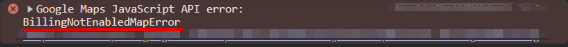

Billing Not Enabled
To connect your map, you need an API key — a digital key that allows the map to load on your site. One of the required setup steps is enabling billing.

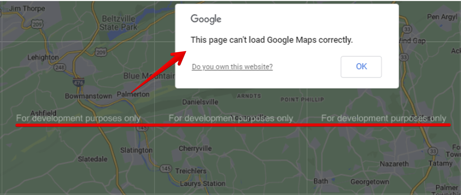

If billing isn’t enabled, your map won’t load, and you'll see a BillingNotEnabledMapError in the console:
You’ll also see the message “This page can’t load Google Maps correctly” or “For development purposes only” in the widget:
To fix this, enable billing for your API key. You can find detailed instructions in our guide: Step 1 – Enable Billing for your Google Maps widget.

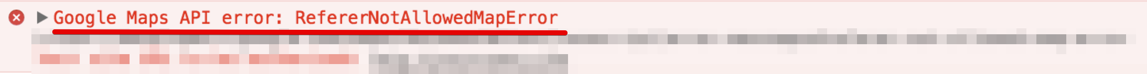

Referrer Not Allowed
Your API key is restricted to specific website addresses called referrers. If the site where your widget is installed isn’t listed correctly, the map won’t load.
In the console, you’ll find the RefererNotAllowedMapError error:

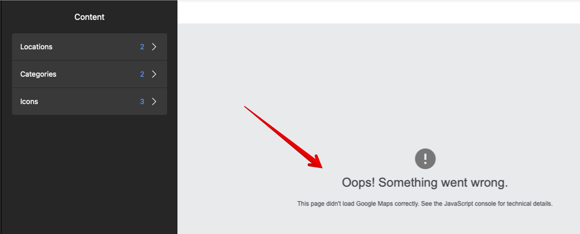

You’ll also see the message “Oops! Something went wrong” in the widget:
To resolve this, add the correct website domains to your API key restrictions. For detailed steps on how to add referrers, check out our guide: Step 2 – Restrict API Key for your Google Maps widget.

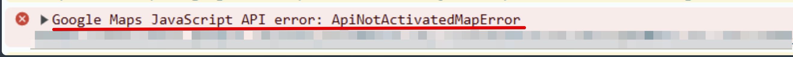

API Not Activated
Google Maps requires enabling specific APIs — tools that allow your website to use various map features. If these aren’t turned on, the map won't work, and you may see the ' Oops! Something went wrong' error in the widget.
In the console, this issue appears as ApiNotActivatedMapError:
To resolve this, activate the following APIs in your Google project:
For setup and activation instructions, please refer to this guide: Step 2 – Enable required APIs for your Google Maps widget.

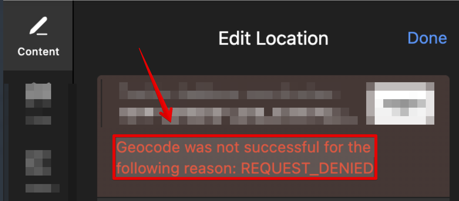

Request_Denied
When you add a location by its address, the widget uses geocoding to convert the address into coordinates.
Google Maps Platform includes 10,000 Geocoding API requests at no charge each month. However, billing must still be enabled for the Google Cloud project associated with your API key, even if you haven’t used any of these free requests.
If billing isn’t enabled, you may see the Request_Denied error when adding locations in the widget editor:
To fix it, enable billing for your project in your Google account. Once the 10,000 free monthly requests have been used, additional requests are charged. For more information, check out Google’s guide: Geocoding API Usage and Billing.
Pro Tip: Instead of using addresses, add locations by coordinates. This reduces geocoding requests, helping you stay within the free monthly allowance.
